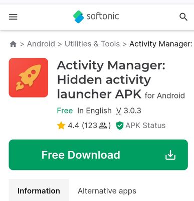

  • Download and install an activity manager app, like the free and open-source Activity Manager app.

Sonibé2025
Thank you for your explanations. On my cell phone, it says that the file might me dangerous, and asks if we want to download it anyway. I'm a little worried about downloading "F-DROID". Is it really secure for my device? Thank you.
The correct app is Activity Manager.
I update the correct link in the post, the direct link to apk. don't worry, it's not dangerous
