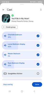

Looped lullabies on Spotify. Each device is a separate 'home' and running their own Spotify, individually given spoken commands to each device. (play playlist, loop play list). Even casting from one device, increases risk of them all stopping and doesn't prevent issue from occurring.

The 4 x Google Home Nest Hub (Gen 2)
