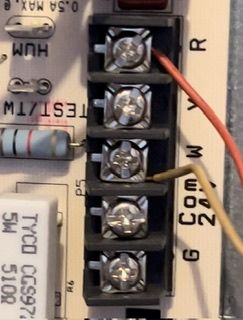

Please send us a photo of your actual furnace control board where the other end of the wires are connected so I can further determine its compatibility with our Nest Thermostats.

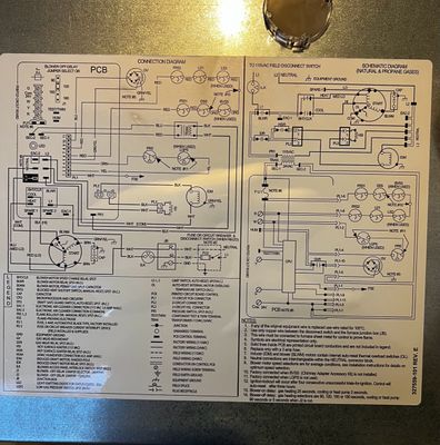

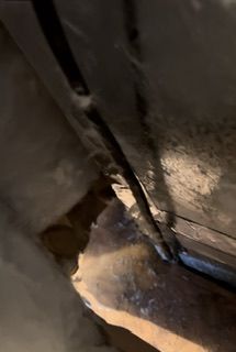

Hi Zoe, thanks for your help!  Here are some pictures of the furnace.  Let me know if you need more information.  Thanks!

Thanks for getting back to us. Your Honeywell Chronotherm thermostat has the non standard labels that we have on our Nest Thermostat though your Payne PG8MAA gas furnace control panel follows it otherwise. In this case, it appears that your system is wired to your thermostat in a proprietary way.
Proprietary systems aren’t compatible with Google Nest Thermostats. However, some proprietary systems can be rewired by a pro installer to be compatible.
