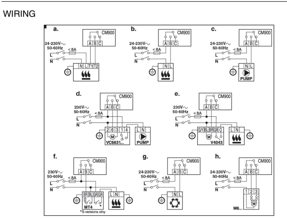

Hi I have an Honeywell thermostat I want to replace with a Nest. Is this compatible. Picture below. If so what are the best wire points. Please

Hi thanks. This is a Honeywell CM907 thermostat. I should have mentioned it is for a gas boiler that runs my hydronic heating only no AC. Which is an Italian ‘Radiant’ brand. Im
located in Australia
Here is a picture form the Honeywell Manual:
Your hookup it probably Wiring a, above.

Hi thanks I agree. It a simple on or off. Does  wiring  work with the Nest?, if yes what are the two letters I would wire them to on the nest?  Thanks
You will need a basic Nest thermostat, the one that uses AA batteries.  The wire connections for your heating will be R and W.

Yes indeed. The thermostat you have does not require a third wire for the power common.

You didn't say what the thermostat is connected to, and there is a high probability that it is a 220-230Vac device that is incompatible with the none UK/Europe Nest thermostats.
Please verify the voltage at the A and B terminals.
