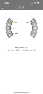

I have the same issue discussed in these conversations. When I set the thermostat to cool, it turns on for a couple minutes, then stops for a couple seconds, then comes back on at different intervals.
This did not happen with my normal Honeywell thermostat and has been a problem since I installed it a couple days ago.
https://www.googlenestcommunity.com/t5/Nest-Thermostats/AC-shuts-off-when-it-shouldn-t-and-then-turn...
https://www.googlenestcommunity.com/t5/Nest-Thermostats/Nest-Gen-3-turns-off-and-back-on-within-a-fe...
Wiring setup now.
Before I removed the Honeywell.

@JasonRai ,
I notice you do not have a wire attached to the C terminal. That might not be a bad thing, We need to check on the technical data. Please go to your Nest Learning Thermostat, wake it up, select SETTINGS, the go to TECHNICAL INFORMATION, and screen shot the POWER data.
The problem you are describing does show up when the Nest Learning Thermostat battery is low on voltage.

@JasonRai ,
When you removed the Honeywell thermostat, was the another conductor wire not attached? Sometimes the technician will wrap the extra conductors around the outer sheath. If there is one, we can use that for the Power Common.
AC Cooling Wizard
No no other wire, I removed the Nest today to double check.
