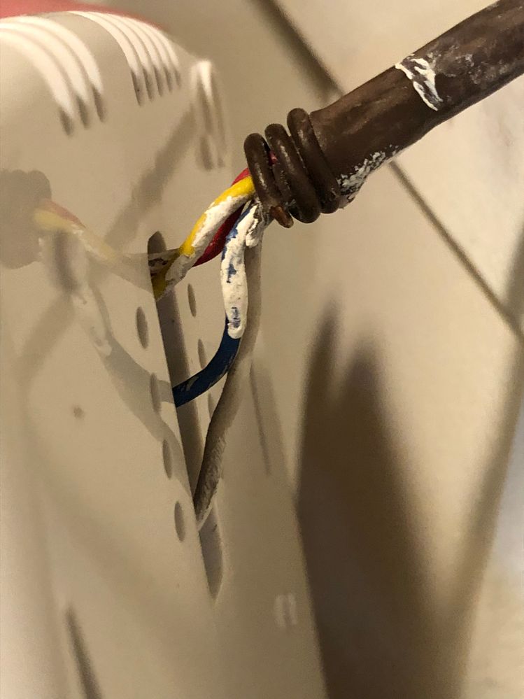

The wire bundle coming out of the wall does have a brown wire, but it is wrapped around the sleeve and was not used on the old thermostat.
Dan
Dan, that blue wire is indeed your common wire, but unfortunately your HVAC contractor did not install a wire to be connected to the G terminal. What I can do is help walk you through how to use that brown wire conductor as your blower fan control and attach it to G on both ends.

Your help is greatly appreciated, thanks. FYI, here is what the wire bundle coming out of the wall to the thermostat looks like.
Dan
Do you have access to the HVAC system? That is, the air handler with the heater system? If so, We can hook that brown wire up as your  FAN control.  You will need to go to the indoor unit, disconnect the power (turn breaker off), open the access door, follow the thermostat wire, find that brown conductor, and if not connected, connect it to G terminal,
