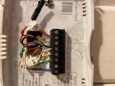

I have an extra wire that I’m worried about where it will go when I install. I think it’s an AUX wire but it was previously labeled “E”? Current thermostat doesn’t use the wire labeled “C” but it’s there and taped. I’m going to post a pic

It looks like you have just a conventional system.
You can verify the wiring by comparing the thermostat to the terminal block on the control board in the furnace/air handler.
I see a C label. Is that on the brown wire?
I guess that the wire labels are from a previous thermostat that this one replaced. SO I would suggest verifying the wiring before proceeding.
Yes, the C label is on the brown wire. I was wondering about that, because from what I’ve read it usually isn’t brown. But kinda assumed it was actually the C wire considering my current thermostat doesn’t use a C wire apparently.
Never trust the wire color as there is no standard.
