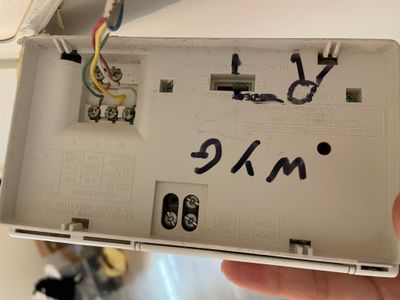

Can my Honeywell thermostat be relaxed with nest?
Patwong7
 Hi - is the best learning thermostat compatible with this Honeywell thermostat?
HVAC
Yes you can put nest stat. I see an extra blue wire not being used need to connect that to C on nest & connect to C/common on your furnace. Good luck.
zoeuvre
@Patwong7, thanks for posting here in the Community forum and for showing interest in our Nest Thermostats. Fortunately, your thermostat wires are compatible with our Nest Learning Thermostat 3rd generation and should be wired to the Nest Learning Thermostat as shown:
Also, here's a guide for the installation and setup of a Nest Learning Thermostat 3rd generation.
Let us know if you have any other questions. We're happy ot help.
