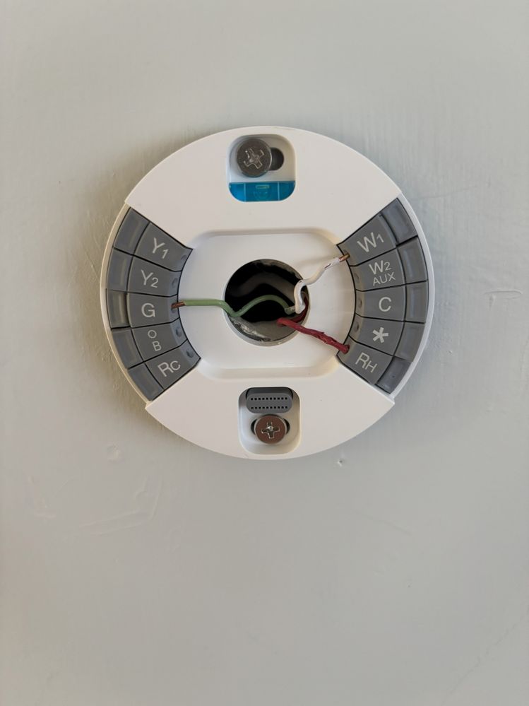

  • Would you mind sharing a picture of the previous wiring installation and the current on the Nest thermostat?

Update:  The low battery warning (zone 1) went away but I just checked again this AM and it is back.  All is well with zone 2.
My zoned system components are as follows:
Viessman Vitorond 100
Fuelsmart Hydrostart
Taco ZVC403 3 zone valve control
The original thermostat for zone 1 (see pic) had white, red and green wires connected to W, R and G.
