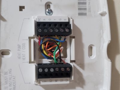

scyank66
American Standard Heat Pump Model #:  4A6H5049E1000BB
American Standard Propane Furnace Model #: AUH2C100A9V4VBA
Pix below.  Is the Nest Learning stat compatible with my system?

Thanks for your interest in the Nest Learning Thermostat. I'd be happy to take a look into this for you.
It appears that your system is compatible with the Nest Thermostats. Wires labeled S1 or S2 can be indicator lights or sensor wires. The Nest thermostat does not need these wires. Install your Nest thermostat without these wires and the jumper wire.
Here's a wiring diagram for you to follow:
