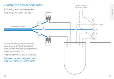

This is how you should wire it using the Google Nest Power Connector.

If you are comfortable working inside the furnace, and you want your fan control back, consider the Nest Power Connector (NPC). It connects inside the furnace to the C terminal and sends more power along the wires you do have to keep the thermostat powered.
From the manual:
At the thermostat and HVAC system you would reconnect G wire back to G.
I thought the the Nest Power Connector simply does what I did - replacing the G for a C.
You are saying that it works differently so I will keep the fan control of my system = I can run only the fan to circulate the air and such????
The Nest Power Connector is designed to provide  power for a Thermostat when there isn't a dedicated C. I haven't used it personally, but yes that it what I am saying.  The wiring diagram I attached is if the HVAC system has a C terminal. You have said you do.
Read through the Nest Power Connector. I think it will solve your problem and allow you to keep fan control.
