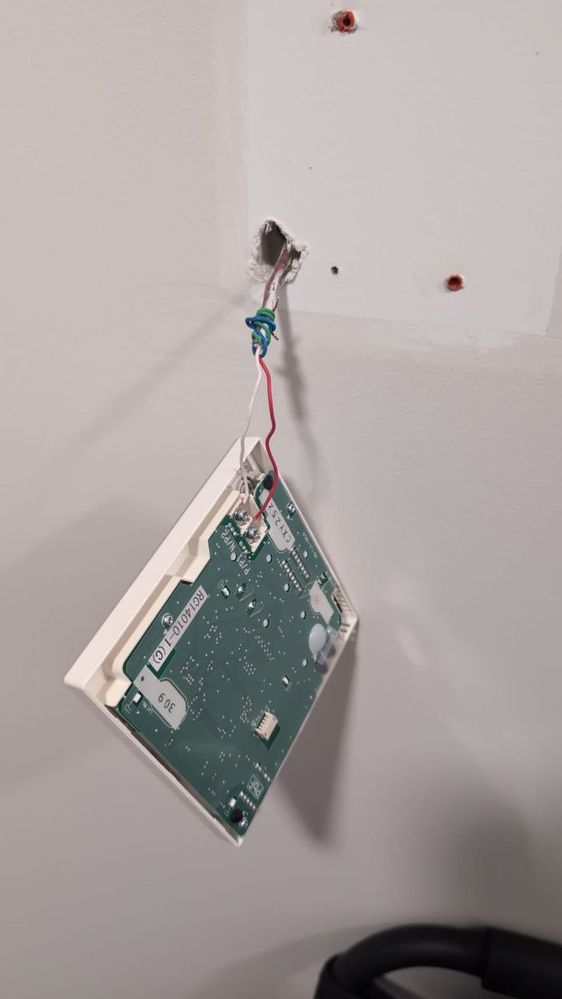

Hi,
I'm looking to check if my system is compatible with google nest learning thermostat (3rd gen) and I guess now that (4th gen) is out, I don't mind investing in that.
I have the following information. Let me know if anything else is needed. I can't seem to find a proper answer anywhere. I checked the nest compatibility test and believe I answered correctly, but the 3rd gen didn't work when I installed so idk.
Let me know if there's any additional questions.

From what I can tell from the information you provided, a Nest thermostat isn't compatible with your system. The main reason is that the controller used for this unit only has two wires, which handle multiple functions.
Nest thermostats use a standard HVAC wiring configuration. This means each wire is responsible for a specific function of your heating/cooling equipment, like the G wire for controlling the fan and the Y1 wire for activating heating/cooling.
Sadly, I don't have specifics on whether your system can be rewired to use this standard wiring configuration, so as it stands right now your system won't work with a Nest Thermostat.

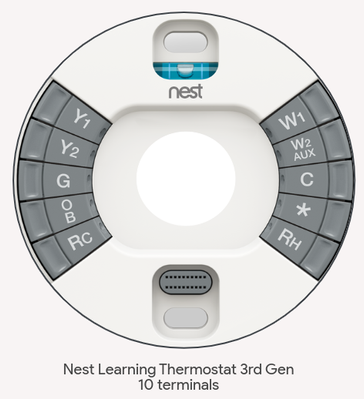

Nest Learning Thermostat.pngHi there!
Thanks for your question.
While we can provide you with an explanation about each wire that you can connect to our thermostats as you can find on Identify a thermostat wire:
If you find a wire label not listed here, or you find a wire labeled Other, you need to contact a pro to check compatibility and have your thermostat installed. As you can see on the picture that I've sent you, there are the terminals you can find on the Nest Learning Thermostat 3rd gen.
