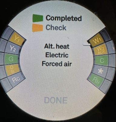

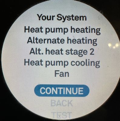

We sucessfully tested the A/C (working great now,) heat pump, and natural gas. My concern is that they put what appears to be the heat pump on W1 and the natural gas on W2 AUX. I want to be sure that it will leave the heat pump off at the set temp and switch over to the natural gas. This is a single stage compressor and there are not any electric heating coils as backup, just the heat pump and the natural gas burner. Is it a problem that the Nest is regarding the first alt heat as electric? Will it just bypas this and go to the gas on W2 as alt stage 2 when it hits 40 F?

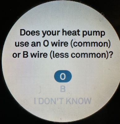

Photos of my wires (techs had some dirty hands and got drywall all over after pulling new wire) and relevant setup screens are attached. If anyone needs other info to help, let me know and I'm happy to provide.

I appreciate you keeping up with the Nest Learning Thermostat 2nd generation despite having a new HVAC system. With its configuration, your Heat pump would be your main source of heat, and the auxiliary heat would only activate when the weather outside is too cold for the heat pump to work efficiently. So it'll only supplement the heat that your system generates through a heating element.
Please take a look at this article and let us know if you have more questions.
Thanks, Mark. Looks like things are good--the article indicates that the dual fuel system should have W1 and W2/AUX wires and that my set temperature at 40 F should switch over to the natural gas system on W2/AUX when it dips below that. Fingers crossed! Nice to have someone in the community to help provide support when a contractor couldn't make good on their claims.
