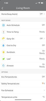

I have an heat pump and the forced air at my home. I want to heat with the forced air when the temperature is bellow -5 because it's making less noise. In fact, if I start it manualy everything is working fine but it won't switch with the dual fuel setting. It will always goes on the heat pump no matter what.

Are you using the Nest sense heat pump balance setting or do you have a lockout temp setup?
I am using a lock out temp setup. When, I put the setting to always, it work on the alt heat without issues. If I lock out the temperature it won't work.
Ok thanks. And you do have the Nest sense balance setting set to off, correct?
I don't find the Sense heat pump balance in the setting, I'm using the dual fuel setting.
Yes heat pump balance is not available in dual fuel systems, but setting the lockout should still work.
  • If you have a dual fuel system, a type of system with a heat pump outside and a separate heater installed inside your home, you won't be able to use Heat Pump Balance. If you have a dual fuel system, you can set a lockout temperature manually in the Nest thermostat's Equipment menu.
I still have the issues that the Dual fuel temperature lock out doesn't work. It will stay on the heat pump. If put the temperature to always, it work properly. It look like the last patch had a bug.
Did you try restarting your thermostat? (long press). My understanding is that the lockout temp setup is compatible with dual fuel but I never used in that mode, and moreover I think you mentioned it worked for you last winter.
