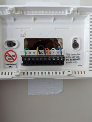

I'm installing a Nest Thermostat and my old system has a few extra wires, such as two R wires and two W wires. What do I do with those?

There's no need for the jumper wire connecting the RC and RH terminal as our Nest thermostats don't use them. As for the W2 wire, connect it to the */OB terminal and you should be good to go.
Hope this answers your question.
