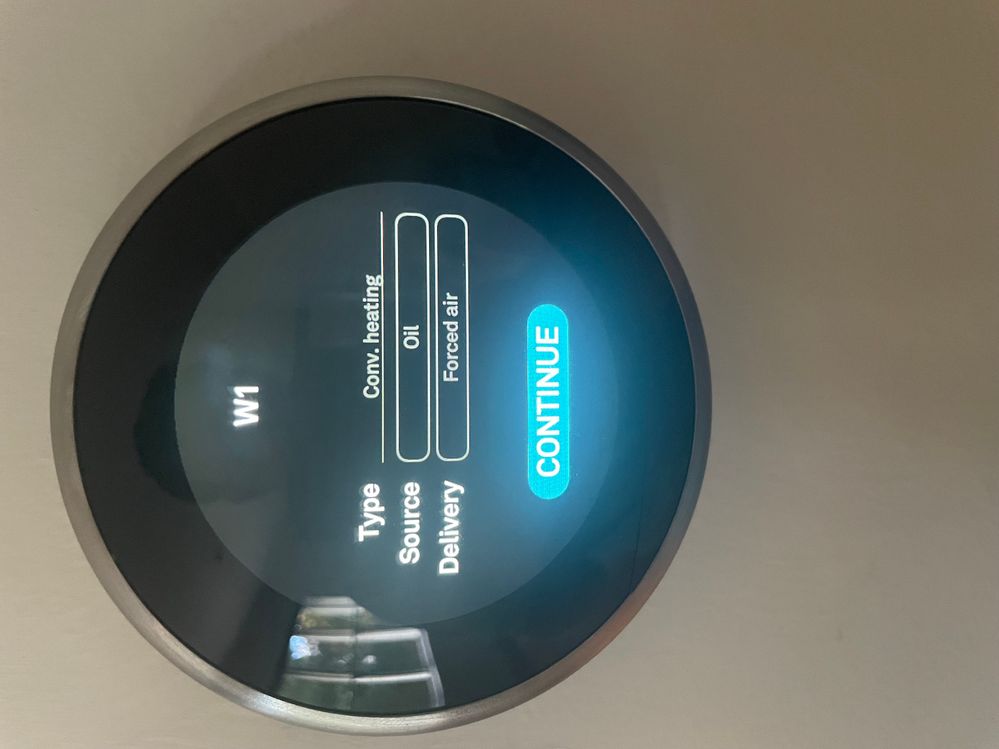

Thanks Ken, well you might be right. Per the recommendation of the support line I bought a new thermostat, installed it and I still have the same issue. I found that in the pro install guide there is an option (under equipment, W1 wire) to set the fan to come on when heat is activated (apparently it is off by default), but I dont have access to that. I contacted customer support again and they are now saying that I need a nest pro installer to come out. At this point I dont know if its the settings in the thermostat or the HVAC control board. I am thinking about giving up on nest and installing a basic one that will probably work

Yes my system an Oil furnace with a hydronic heat exchanger. I found this in the next pro handbook (Page 22) which seams to reference a fan setting for the W1 wire under the equipment settings. Apparently the fan is set to "dont activate" by default. I dont have this option so I assume this is only available to a Nest pro installer? http://support-assets.nest.com/images/pro-faq/Nest-Pro-Installer-Guide.pdf
This is basically where the more complex systems require an experienced HVAC technician to assist in the installation and configuration and it seems that the person who installed that nest thermostat did not do that. I was simply trying to help determine where the problem lies when I advise you to put that Jumper between W and G. Most modern maybe within five or 10 years furnace control systems now have smart control boards in them because they use multi speed fans. They’re typically set up so that they spin at a lower rate RPM for heating and a max rpm for cooling. The thermostat is difficult to control something like that. What I need to help better understand your system is a picture of the manufacture label on the air handler furnace unit. Is that possible to get?

Ken, I think we are getting close but I dont see the option to set the fan when I have the heating system set to Oil. I do however have that option when I set it to gas. Should I set it to gas and give it a go or will that mess up my system?
This is the option when source is set to gas
This is also where you change that don’t active to active scroll down to don’t active, press and click, then rotate to active, then click done
Thanks Ken. My system is an oil system though and when I have that selected as the equipment type, then I dont have the option to change the fan setting. If I switch it to a gas system (which is issnt) then I get the option to change the fan. Should I change my equipment to gas and try the fan option or will that cause damage? Again I really appreciate your help here
It will not hurt the system to set it to gas and set the fan to active.
