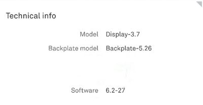

To confirm that it's Wi-Fi-caused and not battery-caused, disconnect the thermostat from the Wi-Fi network for 24 hours. Question: Was there are any message or code on your Nest Learning Thermostat display or recently had any power outages or service work? Also, please gather for me your thermostat's power readings by going to its Settings > Technical Info > Power, then list down the readings for its Battery, VOC, VIN, and lIN.
