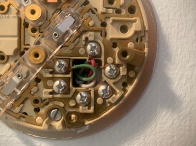

Trying to figure out if my system is compatible with the google nest. Compatibility checker told me to talk to support but it keeps saying it’s unavailable so I figure this would be the next best thing. I have wires going go Y, G, W, and H. Any help would be appreciated.

What you think is an H is really the R terminal.
It is compatible with the Nest Thermostat

09-07-2022 02:15 AM
Thank you. I’m blind sometimes. I see that now. Appreciate the help!
