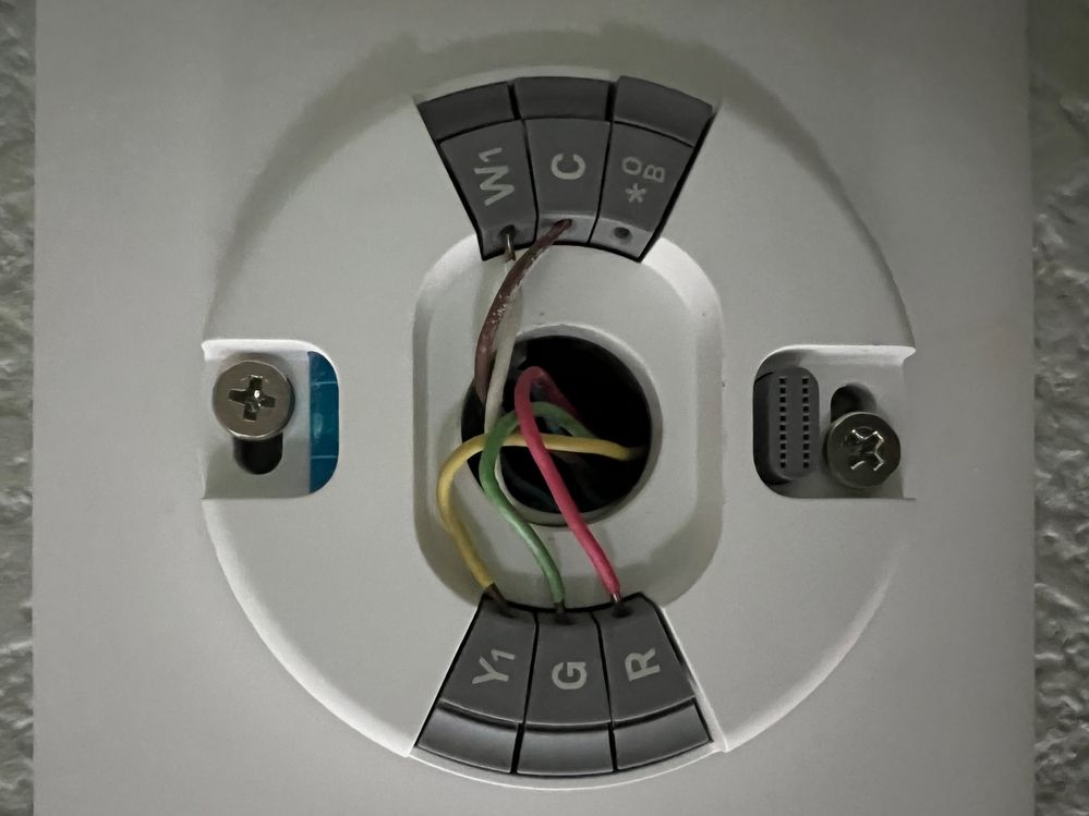

Hi, I'm wondering if anyone can help me. I've been all over the web and Google support and can't seem to find a clear answer.  I just moved into a home that has a Google Thermostat E and had reset it to factory setting in case it's still connected to the previous owner. I failed to make note of the equipment set up and ran into the issue of selecting the equipment wired to the */OB connector. It asks, "Choose the equipment wired to the */OB connector: O/B Heat Pump, Y2 Stage-2 Cool, or W2 Stage-2 Heat." I don't have a heat pump. I have a gas furnace. I have a Split System Cooling Only Central Air Conditioner (Goodman GSX140371KE). As far as I'm aware, I dont have second stage cooling or heating. So for the equipment set up, should I select the Y2 or W2? I'm afraid that selecting the incorrect equipment could cause issue to the system. Or can I disconnect the wire that goes into the */OB completely? Does anyone have any insight into this or can direct me somewhere I can get more info?

There doesn't seem to be an option to upload photos. I dont know if this will help, the brownish wire was wired to *O/B. I have Goodman model GSX140371KE (cooling only, split system, single stage heat and single stage cooling). All other wires go to Y1, G, R, and W1.
The feedback I received elsewhere is to insert the brownish wire to the Common insert instead of *OB and I think that seems to have done the trick. If you have any other pointers please do share.

Hello, I don't have a heat pump. The first two photos were when the brown wire was wired into OB. But when I moved it to C, the set up no longer asks about if I have a heat pump. I think moving it to C solved the problem. brown wire was originally inserted into "*OB"brown wire was originally inserted into "*OB"When brown wire was originally inserted into "*OB"When brown wire was originally inserted into "*OB"brown wire reconfigured to "C"brown wire reconfigured to "C"

Perfect! To be sure, could you check its power readings in the Technical Info? It should show at least 200 under Lin. This will indicate that it's getting power from a common wire.
Hi Mark, can you explain how or to where to check for the power reading?
On your actual thermostat, go to Settings > Technical Info > Power. You should see the status such as Battery level, Voc, Vin, and Lin.

Hello, info shows:
Battery 3.908 V
Voc 38.13 V
Vin 38.13 V
lin 200 mA(c)
Hello NewMover23,
Perfect! It appears that your thermostat reads the common wire. You can leave the wire as it is, and you can also verify how it was labeled from your system's control panel.
