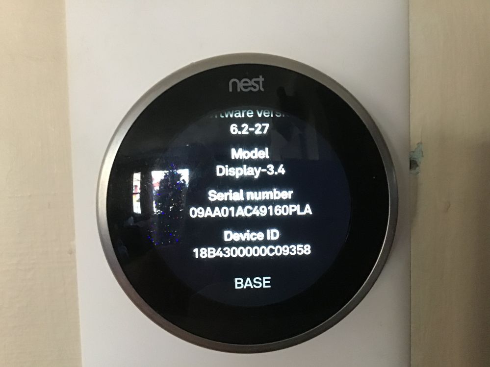

Jhonleanmel
Thanks for posting ― let's get this sorted out.
A few questions: what Nest Thermostat do you have? Check this link to know what thermostat you have. Since when has this been happening?
Mel

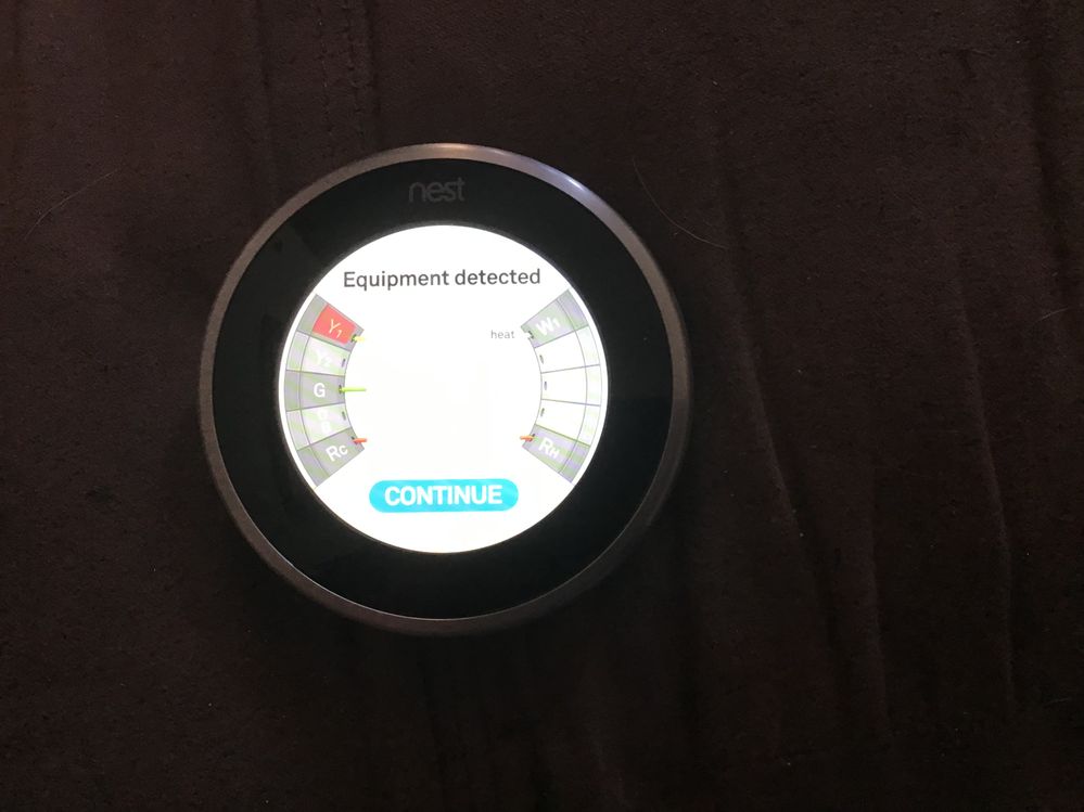

812AD39B-956D-4528-B83E-AADA065C7BD1.jpeg8B509677-8BB5-447F-B763-80A98A35DDE3.jpeg7E629CEB-617A-4D75-BCE9-6341C4F2B832.jpeg7A005589-4642-4F53-B379-3DAE56B43725.jpeg
zneiley
These pics are the info I know. Today I changed out the AC filter to be sure it’s not that.

Hello folks,
I'm sorry for the late response and for the issues you're experiencing with your thermostats. I'd love to know more about this.
Could you share with us a photo of your old thermostat's wiring? This will help us check the configuration. Also, please check your thermostats power readouts in their "Technical Info" settings. I'll look forward to your responses.
