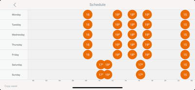

Hi Cristian,
I’d love to share the schedule with you but not sure how to share the screenshot on this chat. Any ideas?
Thanks!
Ellie
Apologies - found the icon! Please let me know your thoughts. For example, in the house it is currently 19 degrees, but the heat is set to 17.5. Am I making any mistakes with the schedule? Thank you!
Hi there @ElliePartington,
Thanks for the details. Could you tell us please what are your Home/Away assist settings? Is only the phone deciding whether you're home or away?

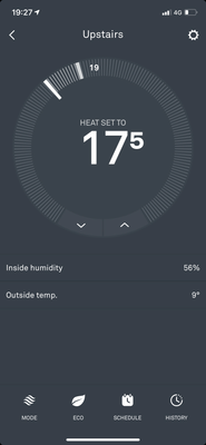

No it’s not just my phone I believe it is activity driven.
This morning the following screen was on the thermostat
Ah my photo is unclear but it said “Your thermostat cannot control this equipment properly”. Please could you let me know how to fix this?
Many thanks,
Ellie
AlexD
Thank you for the information. That would usually pop up when something occurs like a disconnection from the Heat Link. Do you have any LED light on the Heat Link? If so, what color is it?

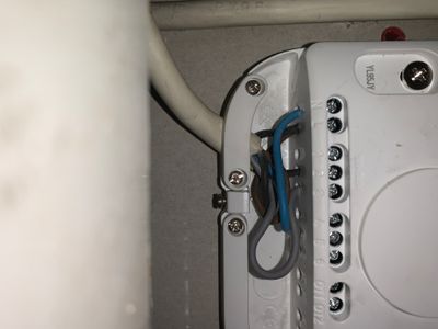

Thanks for letting me know, Ellie. Could you provide me please with pictures of both Heat Links' wiring?
Hi Dragos,
I won’t be able to provide pictures until Sunday but the thermostat that is upstairs just has one wire that goes into the plug socket. The thermostat downstairs is fitted into the wall. Does this help? Thanks!
No worries. Whenever you have time. I'll need the Heat Link's wiring from under the case. Take your time. Have a good one!
Hi there. I'm just following up on our last message. Do you still need our help? Keep us posted.
Hi Dragos,
Is the wiring in this ring?
Hi there, @ElliePartington. That's the base for the display. I'll need the wiring from under the square Heat Link's case please.
Ah ok - let me know if this is what you’re looking for:
Thanks for the photos @ElliePartington. From what I can tell, the wiring looks fine. Can you check your Energy History again? It should tell us why the thermostat started heating.
