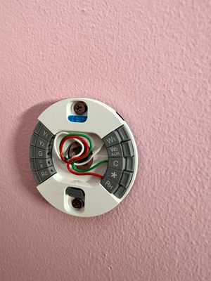

I have a boiler with three wires, R W C respectively. I want to replace the nest recently, but it do
ctmg1991
I have a boiler with three wires, R W C respectively. I want to replace the nest recently, but it doesn't work after I connect the wires. If I only connect R and W, it will turn on, but it won't charge. Can anyone help me? Please

ctmg1991
 I want to know, does it work with nest?

Hi ctmg1991,
Thanks for getting back to us. Could you send us a photo of your previous thermostat wiring configuration instead so we can take a closer look?
