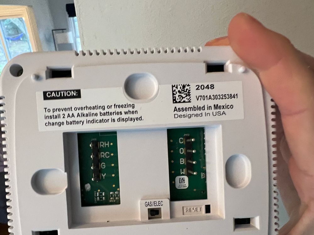

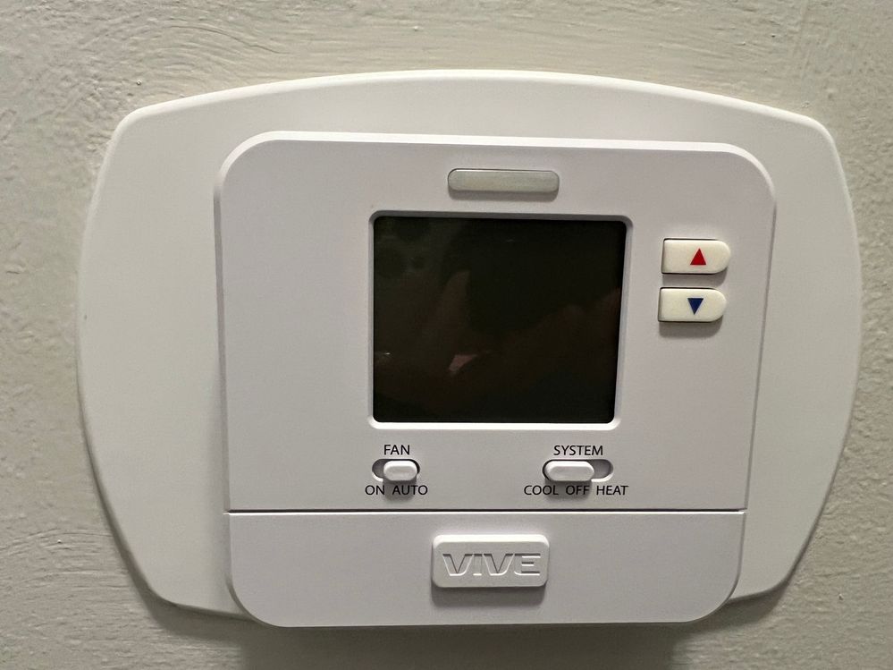

Thanks for letting us know the make and model. Could you also share a photo of both of your thermostats?
Edward
See above!
I wanted to check in and see if I could be of any help. Do you mind me asking if you have an older gas furnace built into the wall or the floor? If not, I am showing both systems would be compatible using our compatibility checker. Please let me know if you have any questions from here, as I would be happy to assist, and answer any you may have.
