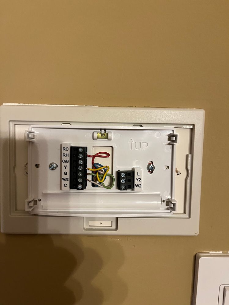

Attaching a picture requesting compatibility check.Currently using Emerson with this setupCurrently using Emerson with this setup

Hello Adi147,
Google has a really easy to use thermostat compatibly checker. Here is the link to it:
https://store.google.com/us/widget/compatibility/thermostat
Looking at the picture you posted, I can see you that you have a conventional HVAC system. Your system has a red wire bringing power to the thermostat and is connected to R (Power IN). A yellow wire connected to Y controls the cooling mode. The Green wire is connected to G and controls the Blower Fan (Auto/ON). There is a white wire on W and this controls the Heating mode. I also see a blue wire that is not connected to anything this wire might be able to be used to connect to a Power Common. At this point I can see no reason your system will not to work with a Nest thermostat. I hope this information helps you. If you found the information I provided helpful, please grant me a 👍“kudo”. Also, if my answer satisfied your question, please select “recommend answer”. Thank you.
Ken, The AC Cooling Wizard
Adi147
Thanks Ken! I did try that and it requested me to post here since I have 2 zones with 2 HVAC systems. Here is my second system picture which has identical wiring except for the Red going in to RC instead of RH for the other one. Should I be able to just put in Nest in both?
Each HVAC system is controlled by an individual thermostat. So each has to be replaced with a new Nest thermostat. The good news about the Nest App is it can support up to 10 thermostats at the same time. On the Nest thermostat the Power-IN is connected to R or Rc for connivence.
Ken
