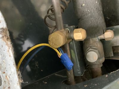

Hello everyone,
Sorry for the delay. Here are some pictures.

Thanks for sharing the pictures. By any chance, do you have a picture of your system's control board showing where the wires from your thermostat are connected to? This is to determine if the 2 bare wires are being used and to tell which terminals we should connect them to the Nest thermostat. Also, do you have a dehumidifier?

yes I do have a dehumidifier. Here is the picture of relay box. Hope its helpful
It's me again. Thanks for sharing the picture of your control board. That helps!
Based on the configuration, it appears that you have a heat pump type system. Your system may still be compatible with the Nest Learning Thermostat. However, with the current wire set up from your thermostat, you might need to contact the HVAC technician or your contractor for the installation to reconfigure it.
