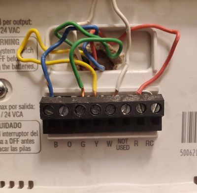

Just asking if my system is compatible as advised on the Nest Compatibility Site.
Johnica1999
@Johnica1999
Your current thermostat is compatible with any of the Nest thermostats.
Try this wiring,
Blue - B to C
Green - G to G
Yellow - Y1 to Y
White - W1 to W
Red - R to Rc or R (jumper not needed)
The "or" is for the Google Nest Thermostat wiring.
