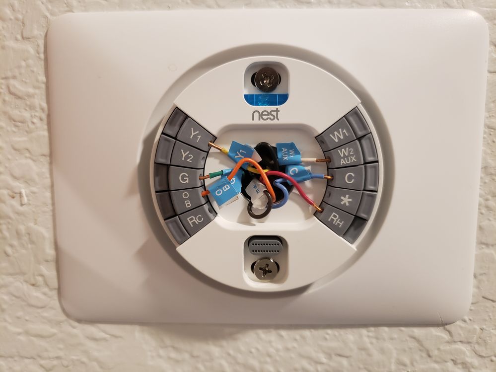

and here's a pic of the back plate.

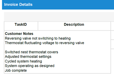

Notes from the final invoice for our main heat pump we just had fixed. They swapped Thermostats with one of our other ones.
When they first visited to diagnose our original problem with the main heat pump the tech went through all of our Nests to check the settings. Everything was hooked up correctly (I installed them according to how it was on the old thermostats, following the installation guide) He made some minor adjustments and pulled the black wire from the * connector ...since even though it was hooked up to old thermostat it apparently wasn't connected to anything. They also rechecked the settings on two other occasions. Several different techs came out over a period of 6 months. Huge headache ...and now we get to do it all over again with another heat pump broken by this thermostat 😞

Hi there @Brand667. Thanks for letting me know and thanks for the video and the picture. That is indeed a US Nest Thermostat. Are you based in the US? That will work only with US heating systems.
