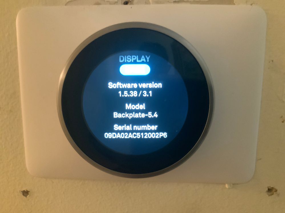

@Jasein ,
here is another thing you might want to check just in case. The nest thermostat has a really nice technical information including that information about the backplate we want to know if it’s looking at backplate properly. To see how you get to that particular support screen on your Nest Thermostat. Goto SETTINGS > TECHNICAL INFO > BASE. This will list for you the information about the backplate. The picture below shows you what it typically looks like.
AC Cooling Wizard

Although it's not clear, the Nest Termostat keeps saying that it can't connect to any devices on my Blower connector (g) and my heat connector(w). However, when I first setup my nest, it asks what the primary goal was for the Nest (which didn't really indicate that it was asking which setting to set the solenoid for. So when I skipped that question, it assumed heat. Every time I would try to cool the place the heater would kick on because it guessed the wrong solenoid state based on the fact that I skipped the question.
So after taking it all apart, removing it from Google Home, Resetting it to Factory Defaults and starting over, it still gives me the error that it can't connect to any devices on (g) or (w) . Which we know for a fact is not accurate because it is actually working somehow. In other words, it is cooling like it is supposed to. It turns on the compressor and then a couple of seconds later starts the blower (that it says it's not connected to).
