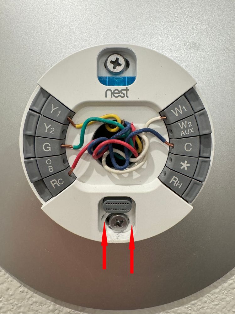

Hi! I Here is the wall base photo. I did switch the display to my other wall base to see if the issue will repeat. And I attached a side view of display when I saw my app showing unit was disconnected (you can see it tilt out at bottom). Please click the photos link. I can’t direct upload photos from my phone. Thanks!
photos
That looks like the bottom fixing is to tight. You can see the installer has overtightened the screw and cracked the plastic. I would try and loosen the screw and get as level as possible. Better still get the installer back to rectify.
I'll try loosen that screw. Currently just doing my "switch display" experiment. Hopefully that also solve the issue. I'll put my feedback later. Thanks!
You can see that the base has been fitted incorrectly as the arrows show. Even the cables are away from the base, not to mention the bottom cracked fixing. May also be worth getting the installer to connect the cables correctly, so no copper is showing!

Hi JuliaC,
Could you reinstall the thermostat base on the wall and make sure it is screwed correctly and wires lay flat on the base?

Hi! I tried to push the wires in and re-screw the base today, if this not working, I'll get a tool to cut those wires shorter so it won't push the display out. Thanks for all the tips.
