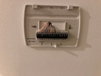

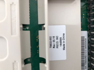

  • Hi here’s a picture of the thermostat model 2A3A417F-F992-4AF0-BD5F-8FB7C07D0B8D.jpeg

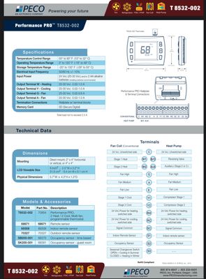

this is a copy of the manual can it help you further confirm all wiring ?
Thanks for posting the thermostat info! It looks like with that thermostat A and E are different fans speeds (med and low). It's a bit rare to have those wires.
Since all the other connections seem standard it is possible (I don't know for sure) that you could use a Nest, but may have to settle for a single fan speed control from the thermostat. However, Google recommends pro installation for systems with multiple fan wires.
