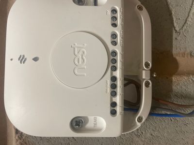

03-20-2022 03:32 AM - edited 03-20-2022 03:33 AM
Hi Alex,
Thanks for your reply!
So…
Yes I hear the clicking from the heatlink, when you adjust the temperature on the thermostat, however it doesn’t turn the boiler on.
An electrician has checked the wiring, but this is what they look like:
2nd picture is the underfloor
First is the radiators and the hot water.
Thank you,
James

Thanks for the pictures. From what we've seen in here, it seems that one Heat Link is not wired accordingly, second picture looks alright for a combi boiler with hot water on demand. Just to confirm, the first picture is for the hot water and heating for one zone?
03-21-2022 10:49 AM
Thank for your reply!
The first picture (two white cables in) is for the radiators and hot water.
The second picture is just for the underfloor heating in the kitchen.
I have a system boiler set up, with a hot water tank.
Thanks for advice,
James
03-22-2022 05:32 AM
Thank you @JamesT. It seems the first one is not wired correctly. Do you have an S plan or a Y plan system boiler?
