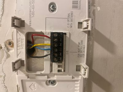

 can anyone tell me if the nest is compatible with these wires. Any chance you know the configuration ??  Thanks in advance
David_K
That setup is compatible with any of the Nest Thermostat models. You would connect the wires as follows.
  • Connect Y to Y1 in Nest Thermostat.
  • Connect W to W1.
  • Connect C to C.
  • Connect R to RH.
Thanks for the help davidking.
