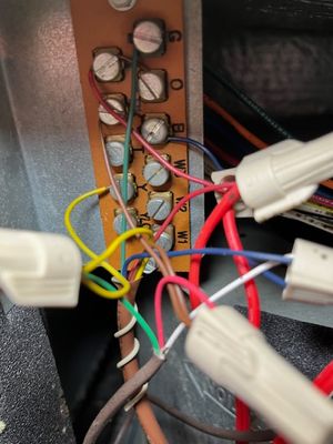

Hello,
The existing thermostat controls a gas boiler (Rh & W) and attic air handler (4TEE3F31B1000AA)/ compressor (4A7A6024B1000AA). Looking to see if the blue is my common wire and the brown wire I believe should actually be on Y2. Tracing the wires around, blue goes to B on the air handler and compressor. The brown wire goes to BK on the air handler and yellow/red wire on the compressor.
Honeywell Thermostat
Trane Air handler
Compressor

Read this link about Trane BK function
https://www.reddit.com/r/Nest/comments/c95xj5/bk_wire_on_trane_xl624/

Thank you for everyones help. I haven’t had a chance to install the thermostat yet but i think it should work.
I appreciate the followup, @Jhonleanmel.
@Mandela64, thanks for the update. Based on the link shared by Houptee. The BK wire will control your in-home dehumidifier. If your system has a dehumidifier wire, or more than one dehumidifier wire, you might need a professional installation. Also, the blue wire is to the C terminal for Nest, then follow the reset of the wire set up.
Have a look at this article and let us know if you need more help. We would be glad to know what would be the result.
