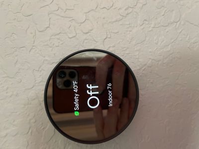

Just got a nest thermostat set it up and I have two old thermostats. One for entire house and one thermostat that just controls upstairs. I installed nest in main downstairs here is the wiring
When I run ac it blows out heat not ac and it does it in my upstairs bedroom that is on its own thermostat. Here is the wiring on upstairs unit
 here is my best unit I installed
 here is my wires
 any help would be appreciated. When I turn on heat on nest unit it turns on ac??  But this nest is controlling my upstairs unit I don’t no what to do please help!!!

I can only make some assumptions based on your wiring and what you say is happening, but I have a pretty good guess.   The Orange or Brown wire is often used in a heat pump system to indicate which direction the heat pump needs to operate in: heating or cooling.   It sounds like the Nest did not get set up to correctly know this was controlling the heat pump changeover valve.
I've not had to reconfigure this, so I'm not sure if you need to just reset the Nest settings and configure it again, or perhaps just unplug the O/B wire and then plug it back in so the Nest senses that it's there and then asks to configure it.

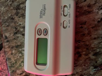

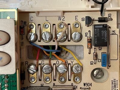

I fixed it. Issue was I had a jumper wire on both my thermostats. Now it’s blowing cold ac. Thank god. Here is a photo of my main thermostat downstairs.  Had white jumper from w2 to e. Once I hooked that up it works perfect.
now should I try to hook the new nest unit back up now that everything is working?  Do I jump the white wire on the nest unit when I hook it up?
 as you can see the white wire broke.
E & L terminals are for activating the emergency heat relay and emergency heat lamp (which help get the heat pump up to operating temp in cold temps).   That is really interesting that it is not working correctly unless the white wire has been jumpered to E.
AFAIK the Nest does not support emergency/auxiliary heat controls, though perhaps that can be configured by a Nest Pro on the Learning or -E models.   Maybe @Patrick_Caezza can weigh in on that.
You didn't by chance happen to bump the switch to Emergency mode did you?

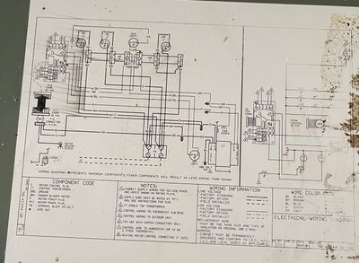

 this is the unit upstairs that controls zone for one room upstairs that I have.  I took off jumper cable and did not take photo and not sure where it went.  Now when I turn on ac it blows heat out of wrong zone. So I have broke my entire house ac/heat.
