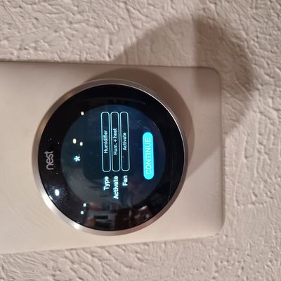

So I figured it out! First I believe you have to have a Nest learning thermostat gen 1 2 or 3.
*Secondly, you have to wire it to the astric terminal of the thermostat. See this YouTube wiring diagram.
* after you connect it you'll have to go into the Equipment go into the Pro Setup and set up the humidifier.
Hit continue.
Turn the dial until the "*" highlighted ( it should be yellow instead of green if it's not set up) and press /select it. Then select each of these and hit continue.
not sure if the settings that I used are the right ones, but it's working for me. Type:humidifier, Activate:humidifier and Heat, Fan: Activate
Hit continue and Done.
Go back into your EQUIPMENT. Continue until you get to your equipment settings. SELECT HUMIDIFIER then SET HUMIDITY. You'll have three choices. Select the dial for one droplet two droplet or three droplets. Select the desired level and then hit done

So, I don't know if you still need help, but this has been answered several times. Go into pro settings, under humidifier, chose when heat and fan come on and it will only bring Humidifier on when those two conditions are met. Mine was set like this, but my humidity level was getting too low in the house because I am running a fireplace to heat my home. I was getting into mid to low 30% and getting shocked on everything I touched. I am currently at 47%. Today is the first day I have changed the settings and it has brought humidity up 4% in 6 hours, so it does take awhile. I am shooting for 50%
11-27-2022 03:50 AM
Thanks for the "Pro" tip! 😉 I just tried it and the Nest thermostat asked me to put in a a Pro ID. I tried entering something random, but it appears that the thermostat validates the ID.
11-27-2022 05:59 AM
The pro ID, isn’t what you need to go into. Go into the one that says equipment. Scroll up through the post and find the pictures with directions. They work after you make sure your wiring is correct. Make sure you have one wire coming from the * on your thermostat going to one of the wires on water valve on the humidifier and the other going to com on your furnace board. If your thermostat is controlling your humidifier now, you know it is already correct. Then the only thing you have to do is change it in the programming of your thermostat.
