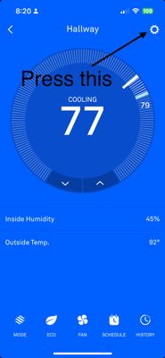

@SuperDave-O
Here are the screenshots off the Nest App on my iPhone
1. Select your thermostat

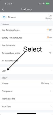

 2. Select the settings gear
 3. Choose Lock, enter lock PIN twice.

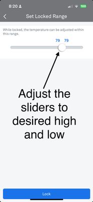

4. This screen should appear, adjust the sliders, tap LOCK at the bottom.
