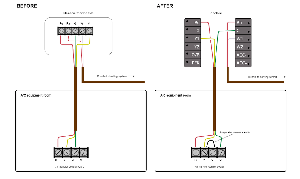

Can you please share some pictures of your wiring diagram that you are recommending?
09-20-2022 02:20 PM
I am curious to see that too.
09-24-2022 10:21 AM
Hi @Chobes and @SofianeMTL ,
Here are some pictures with captions and I'll explain a little as I don't have a final picture of the board which is hard to access and I don't want to get cellulose all over again. Pictures are not in order but follow the captions. Don't forget to shut the power off to the system. So first I realized it is not as simple as what this ecobee diagram shows as our ac equipment (air handler and compressor) has wires connected right before the air handler. So the wires from thermostat does not directly go into air handler board. So what I did is first opened up the air handler board and followed the G and C wires (it turns out although I don't have C in the wall). C on the board has a brown wire (see board pic) and comes out to wire junction and connects to blue thinner wire (see before pic). So that is where I connected my G wire (green wire, see after pic), so ending up connecting three wires there. This is the first part and you may want to check if this is enough to do the trick which I didn't and went ahead and did the second part which is jumping G to Y on the board (no pic sorry). You find a little piece of wire strip both ends and connect the Y to G on the board. That is green to yellow. Since my board wire insertions were not that straight forward I had to push the jumper wire in the hole right under the wires. If you look closely the yellow Y wire on my board pic you can see that opening. And finally on your Nest base switch G to C (patient pic) and start the system.
Since then Nest does not need twice weekly manual charging. But I still have N72 error message on there and the Rh wire shows "power" grayed out. Interestingly it is not grayed out on my Nest app on my phone. And C is immediately recognized. The battery voltage is now always above 3.9volts which was fluctuating between 3.7 and lower values depending on how much I charge it.
I feel wiring part maybe a little not too clear but for people here I think we now are trained electricians 🙂
Hope this helps.
ecobee GtoC conversion
After, thermostat, air handler, compressor wiress
Before, air handler control board

Thanks for sharing. So the Rh is still greyed out? Does the rest actually stay running? I don’t have confidence if I tried this that my heat would run since nothing would be different on that transformer side.
10-07-2022 08:34 AM
Yes Rh is greyed out but behaves as it is ok. Heating is working fine for me. I think if your system is like mine, it is worth a try if you want to really stick to Nest. Also what I understand from EcoBee manual is you'd need a C wire anyway. Not sure about the other smart ones but for Nest and EcoBee you'd need either the G-C conversion or power adaptor.

Shouldn’t need to jump the G and Y. With the G conversion you just can’t run the fan separately but it will always come on when the yellow gets power.

Yes! 😁 I finally got fed up with Nest - was even going to try buying a new Nest base, but with the scalping going on ($100 for a new base, yeah right) I couldn't consider it.
I finally got an ecobee Smart Thermostat Premium about a month ago, and I love it so far. It works with our C-wire setup. I have these wires connected (but, of course, read the instructions several times, because I installed my own C wire, there could be something weird about my setup, and so on)...
From the aquastat relay for my gas-heated boiler:
From my air handler:
new ecobee base; thicker Rh & W1 wires are from boiler
