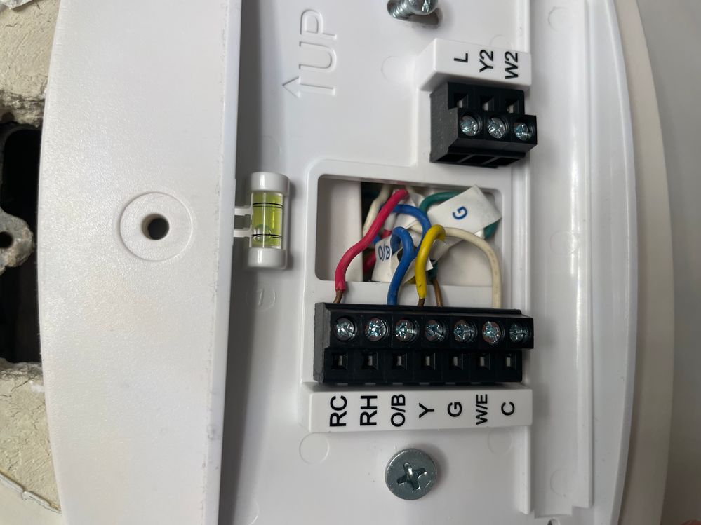

I would like to replace the an old thermostat with this wiring scheme with the nest e. I will need to add a common but where does the W/E wire on this diagram connect to on the nest e thermostatFBB6CE92-4D96-4946-AEC9-DCC194A4C2BC.jpeg

Your system is a Heat Pump system.  The E/W is your Auxiliary/Emergency heat.  When you install the Nest, you enter the system as a Neat Pump, Forced Air, and the wires I use are R, Y, O/B, E, G.
