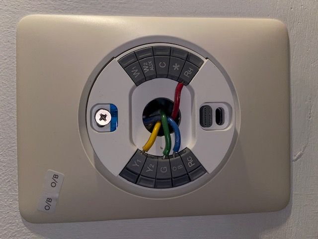

Hi,
My nest won't stop working although the set temperature has been reached. I saw one of the responses that mentioned removing the nest from the back plate to see if it stops, and it did the minute I took it off. As a result I always need to check the app and see if the temperature has reached and turn the mode off so that it stops heating. Can I get help resolving this issue?

Hi Eitan, Thank you for your answer. See answers below:
  • What type of Nest thermostat do you have? It's a 3rd generation
  • Is this a new installation? If not, when did the issue start? This is not a new installation. It's at least the 2nd winter since this has been happening
  • Do you have conventional or heat pump system? Heat Pump system
  • When was the last maintenance check for your HVAC system? Summer 2024
  • Has there been any recent changes or upgrades to your HVAC system? No
  • Does the issue happen on heating only, cooling only, or both? I only use heating
  • Do you have a common ground wire or C wire? I do not know
  • Have you experienced any power outages within the last few days or weeks? None
I recently disconnected and then reconnected the sensor that I am using to set the temperature and the issue is persisting.
May I ask why I need to disable the schedule? And why check the energy History .... I know I am using my heat too much considering the system does not work.
I will check the wires. They are well placed, I need to check if they are well inserted.
It also feels like sometimes the air that is coming out with cool instead of hot.
Thank you!

Hello @Naw1
Thank you for the follow-up information and the pictures you have provided!
The team would like to learn more about this behavior. When you get a chance, please fill out this form and let us know when you’re finished. We’ll have someone reach out to you via email from there.
