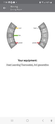

I'm getting an e72 wiring report Reading on my Nest. It's saying no power wires detected. Rh or Rc wires required. I've pulled off the the knob and the red RH and RC wires look both connected. We have not turned on the HVAC system. And haven't been using the Heat. It was only set to heat. We haven't tried yet setting it to cool. There's no problem with fuses; all the other power in the room and adjacent rooms is on. Can you help me?

To better understand this, could you please share your thermostat's wiring setup? Also, gather the power readings in the Technical Info settings.

06-28-2023 05:25 PM
Hi Mark, thanks so much for your reply. I sent you screenshots of what you need, I hope that covers it. They are the power readings in the technical info and the thermostat's wiring setup. Please let me know if I can help or provide anything else.
Also, FYI, I had a air conditioning person come out to see the system. He found that there was no power going into the system. He checked the breaker and it is in the on position. He thinks that I need an electrician.
Best regards, Marc
