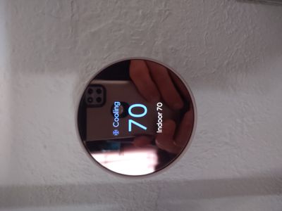

05-14-2022 12:27 PM - edited 05-14-2022 12:30 PM
Went to the control board on unit and the common wire was not in common terminal, was in R terminal. Switched wire to C terminal and Nest is now cooling.
Also CNYTeddy, pull the Common wire out of Nest terminal and tuck away from the other wires & mount Nest back on wall and try cooling mode without common. If it works without immediately shutting off, then it's a problem with where the Common wire is connected on your units control board. Hope this helps.
