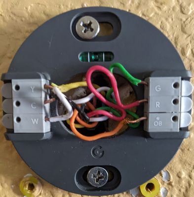

I just installed my Nest and the Heat function is not working properly - it’s just blowing cold air. Picture attached with set-up. I called customer support for an hour tonight and they had me remove the blue OB wire (didn’t work) and then also remove the yellow Y wire (didn’t work). I also tried resetting the thermostat, removing the device from Google Home, and doing the set-up again but no luck. Hoping someone here can help me!
Info: Forced air. Gas furnace (inside the house). Box outside the house that I think is AC. I have been really confused with the dual fuel system/ heat pump references. I believe I said No to that question during set-up?
I had a Honeywell thermostat that was working just fine. Here were the settings:
Blue - B
Green - G
Yellow - Y
White - W
Red - R
Jumper wire connecting R & RC

I am no expert, but I have a similar set-up and my blue wire went to "C" in my old thermostat, so that's what I did with Nest. I just installed it and it seems to work, but I haven't needed real heat yet, so time will tell.
Thanks for the tip. I tried that tonight but still not getting any heat.
I tried putting it to C terminal again after my initial reply but this time I removed the device from my Google Home and I redid the set-up. The heat worked for 5 minutes! Then turned cold again 😞 I updated the B wire to O wire in app in case that would help but no luck - cold air.
eveluna
Can you try to change the heat pump orientation? Kindly follow the steps with this link: https://support.google.com/googlenest/answer/9257086?hl=en
I tried this tonight as well. Had my blue wire in O/B terminal and changed the setting on phone from B to O. Still no heat.
I don’t think I have a heat pump - I  googled my AC unit model - though I’m still not 100% certain, (VSX130421).
I tried the non-heat pump suggestion of connecting the blue wire to C terminal and that didn’t work either.
I think I said “No” to the dual fuel system question. I’m wondering if that could be the issue? I have a gas furnace. I’m confused!
Kindly follow the instructions on this link here: https://support.google.com/googlenest/answer/9235232?hl=en , if there's no changes, have a tech come over to check what's going.

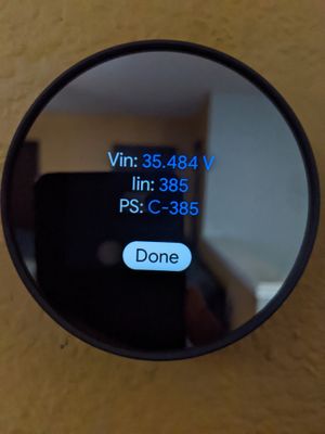

Sorry for the late reply and to hear about the trouble. I wanted to follow up and see if I could be of any help. Do you mind me asking if you still have the Nest Thermostat? If so, are you able to check the power readings shown on the device? Please let me know, as I would be happy to take a closer look and assist you further.
Hi Jake - On my last call with Nest support they had me switch my Y and W wires as a test (yellow going to W and white going to Y). My heat is now working, though I’m not sure if I’m supposed to keep the wires like this. I’ll call Nest later today to confirm.
Nevertheless, here are my current power settings;
Vin: 32.354 V
lin: 385(W)
PS: Y-42, YW-385, W-385
I am glad to hear the heat is working, and your house is being warmed. Taking a look at your power settings, I am showing you are getting a stedy amount of power. Let me know what the support team says, or if you have any other questions from here, as I would be happy to review.

@endoskeletons, It appears that you have a conventional type system based on the wiring configuration from the old thermostat. Let's sort this out.
  1. Turn off the power to your HVAC system at the breaker.
  2. On your thermostat. Move the wires back from the way they were with Y (yellow), W (white), G (green), and R (red).
  3. Move the blue wire to the C terminal.
  4. Turn on the system's power and reset your thermostat to default.
    1. This is to re-configure your system as a conventional system rather than a heat pump.
  5. Open the Google Home app and remove the thermostat, then proceed with the set up.
  6. During the process, make sure to select the wires in their current configuration.

My thermostat has been working with the new configuration (3 of the 5 settings are different than the ones initially suggested during set-up LOL) but I don't know anything about thermostats so not sure if it's OK to leave them wired like that.
Blue - C
Green - G
Yellow - W
White - Y
Red - R
I believe I had already tried the approach you mentioned two weeks ago - with YWGR listed as you mention and with B to the C terminal. With that set-up, I had reset my thermostat, removed it, and proceeded with set-up again. However I am clearly missing something... I've never been able to set up the thermostat without the app showing that I have a heat pump 😕 I can screen record my set-up process if/ when I reattempt the B to C + reset steps you mention.

Disregard my prior note. Only my heat works with the current settings. So when I have Y wire with W terminal and W wire with Y terminal, I can only get heat to work (on both Heating and Cooling modes). And when I have Y with Y and W with W I can only get cooling to work.
I’m guessing I should try your suggestion above of putting Y to Y and W to W, keeping B on C terminal, and removing/ resetting my device. I am confused though - I've never been able to set up the thermostat without the app showing that I have a heat pump. How do I make that happen?
That was exactly my concern as switching those wires is only temporary. Right now I'm running it that way while I wait for support to get back to me.
During the setup, to avoid it saying you have a heat pump, when identifying the wires in the app, tell the app you have a C wire instead of O/B and see if that helps.
