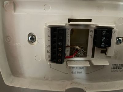

Hellokidd1122
I was asked to share a picture to see if it’s Compatible
14 REPLIES 14
Hellokidd1122
Only
*w
*R
are connected
Don’t have an R option only RC and RH available so which one of these two should I put R in ???
The terminal for the R wire will depend on which Nest thermostat you have. If there is an RH, it will go there. If there is only an R it will go there.
W will go to W or W1 depending on model.
Also, be aware, in some cases a C common wire is needed.

tbdew
is my wiring compatible with a Nest Learning Thermostat?Lux Thermostat wiring.jpg
I wanted to follow up and see if I could be of any help. Do you happen to know if the B wire connected to your device is actually a C wire? You can use the link here if you are unsure. Please let me know if you are still having any trouble from here, as I would be happy to take a closer look and assist you further.

tbdew
How do I insert a picture?
tbdew
