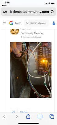

I have a 1st generation nest thermostat that’s been working fine. I changed my Wi-Fi  settings and my thermostat wasn’t connecting to Wi-Fi and I couldn’t get it to reconnect so I reset it to factory default. I went through and set it up and got it online but now when the thermostat calls for heat all I get is cold air. I figure it has to be one of the boxes I checked during set up. It’s a Bryant 80% forced air gas unit with an AC. Wiring was not changed during re-setup

I have this same issue, I also noticed that it says heat source is electric which mine is not and I never was given an option to choose my fuel source.  Did you ever get yours resolved?

thanks for the follow up. I did mange to resolve my issue some what by telling the system after a reset that I have a dual system in order to get hearing to work and the app to stop displaying electric heat. I do not have a dual system but this was the only way I was able to make it work. Not sure if that will cause issues down the road but I think the thermostat is only made for electric or dual system which is not specified anywhere. Had I known I would have purchase a different thermostat. But I’m good now. Thank you
