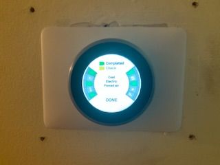

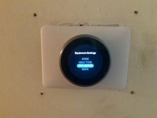

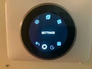

326730482_1810631925977501_449290697277184817_n.jpg325841964_503967645197835_2432646517751861955_n.jpg326505857_541410437945715_469206279206287159_n.jpg
Csoule
This is what I see on my Nest...I really do appreciate your help and time... I apologize that the pics loaded in reverse

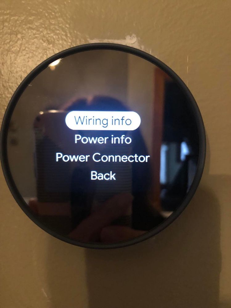

Csoule
this is what I see when I chose  wiring infothis is what I see when I chose wiring info
OK, you have simple model of Nest, my pictures were from a Nest Learning Thermostat
