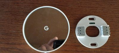

I have a geothermal unit that has a heat pump I have two wires left over on my new Nest Thermostat wiring block. A W-2 and a Y2 there's still one terminal left on the wiring block it's a star OB which one goes in it and what do I do with the other one. Thank you for any help. I posted this a couple weeks ago and I did not see a reply by the by the time I did it was too late to reply myself. I will attach pictures this time if I can figure it out thank you

It doesn't look like it's going to allow me to post a picture that I've already taken. But it will allow me to post one that I take so when I get home tonight I will take another picture and send it to you

This is the one they sent me

Yup, your system is not compatible with the Google Nest Thermostat, which is what they sent you.

well if it wont work with my system I will have to get with nest and see if they will take it back and send me one that will work. Thank you
