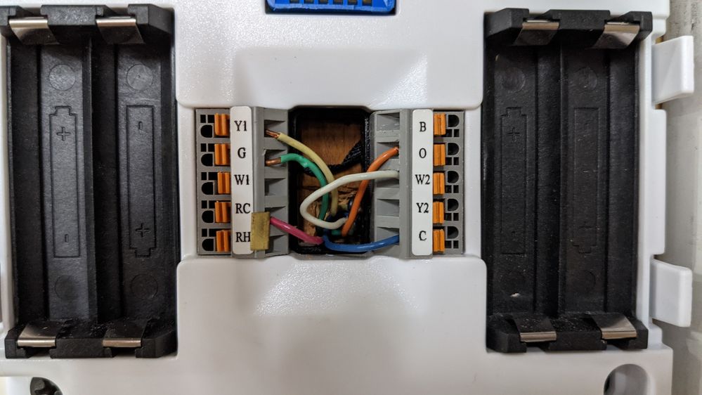

I have a Goodman 10 ton package unit that I am trying to install a Nest Learning Thermostat on.
When I first installed it the previous thermostat only had a Y1 and when hooked up that way I got a fault when I "tested" the wiring.  I have gone to the unit and found that the unit has Y1 and Y2 jumpered together.  I have removed the jumper and connected an unused wire (brown) to Y2 at both the unit and the Nest.
I am not getting the error any longer but I am not sure that the second compressor is coming on.  I am in a commercial building and really don't "need" two stage cooling (it barely keeps up in the heat of the summer) but it seems the nest doesn't like that setup.

not really, I had to take the nest out and put the old thermostat back in.  Best I could tell the 2nd compressor (not stage) was not running (and I am NOT a HVAC guy)
When I only one Y1 was hooked up and the Y1 and Y2 were jumpered at the unit, it kept throwing the error.
