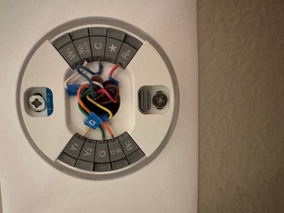

I went to turn on the heat this morning and was not getting any warm air. I set this up in the summer, so I have only used the cooling function. We are renting an apartment so I don’t know much of the details about our furnace. Could anyone give feedback on the wiring to see if something doesn’t look right? I have posted my current wiring and the wiring from my old thermostat.

Move the red wire to RC on Nest and see if that works.
Todbone
Switch the white wire to W1.
MichaelRuiz91
Thanks for everyone’s suggestions. I tried each of them last night and unfortunately it still isn’t working. I put back on the old thermostat and the heat works fine so it isn’t a furnace issue.

Checking for system orientation might help too. You can go to your Nest thermostat's equipment settings to change the configuration. Have a look at this article and let us know if you need more help.
