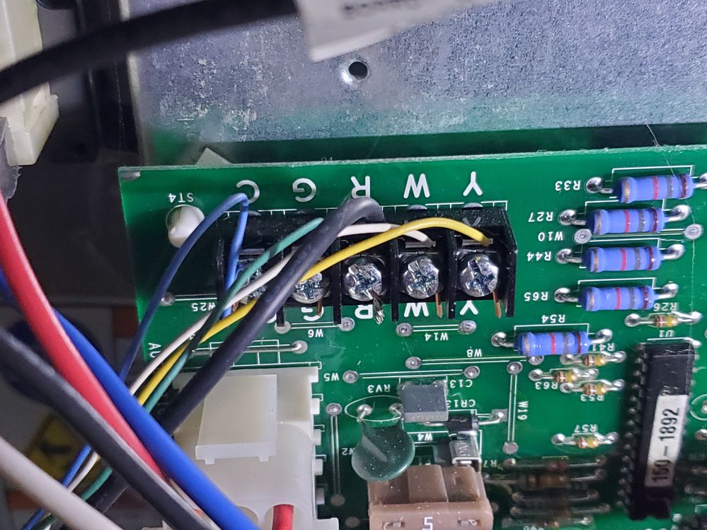

OOPS.  I had uploaded the wrong unit's control panel pics.  Here are the correct ones. The HVAC is American Standard Model 4A7A4024L1000BA.

It turns out there is a Honeywell panel attached to the HVAC unit.  The current thermostat is of Honeywell.  The white, yellow, green wires that were not connected are really not connected on this panel.  Thanks.

I have the same thing as the guy above. There’s a control panel that is using 2 wires that go to my thermostat but then that control panel goes to a secondary one with all the colors on it. I think he shows it in the picture. My thermostat does have all the wires behind it as well. I think we have the exact same system. My wording may be confusing though. I’m trying to figure out how to send pictures.
Just like Young’s last pic of the Honeywell panel, none of the wires other than red and blue are connected (they’re wrapped around the main chord and don’t plug into the panel itself) I think we all have the same setup and are wondering how to connect those wires to the panel correctly to be able to have a functional smart thermostat.
So—Red and blue are connected to C and R, on the thermostat end, and those same wires go directly into the Honeywell control board C and R.  All the other wires (yellow green and white) are disconnected on both ends.

ABA1EEDF-9C5C-4846-AC1F-A14E4A0559A9.jpegI circled in red where on the board C and R are attached in young’s photo. I have the exact same setup and I’m sure everyone else in this discussion do as well.
