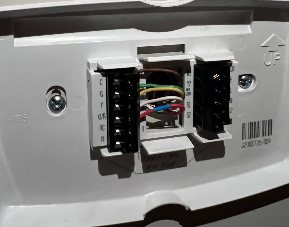

Thank you for your quick reply! We have a Gas Furnace AC system. Original thermostat:
01-10-2023 09:07 AM
Crap! After looking at the pic closer, I see I used the outside labels and not the inside labels! White indeed goes to W and not OB.
